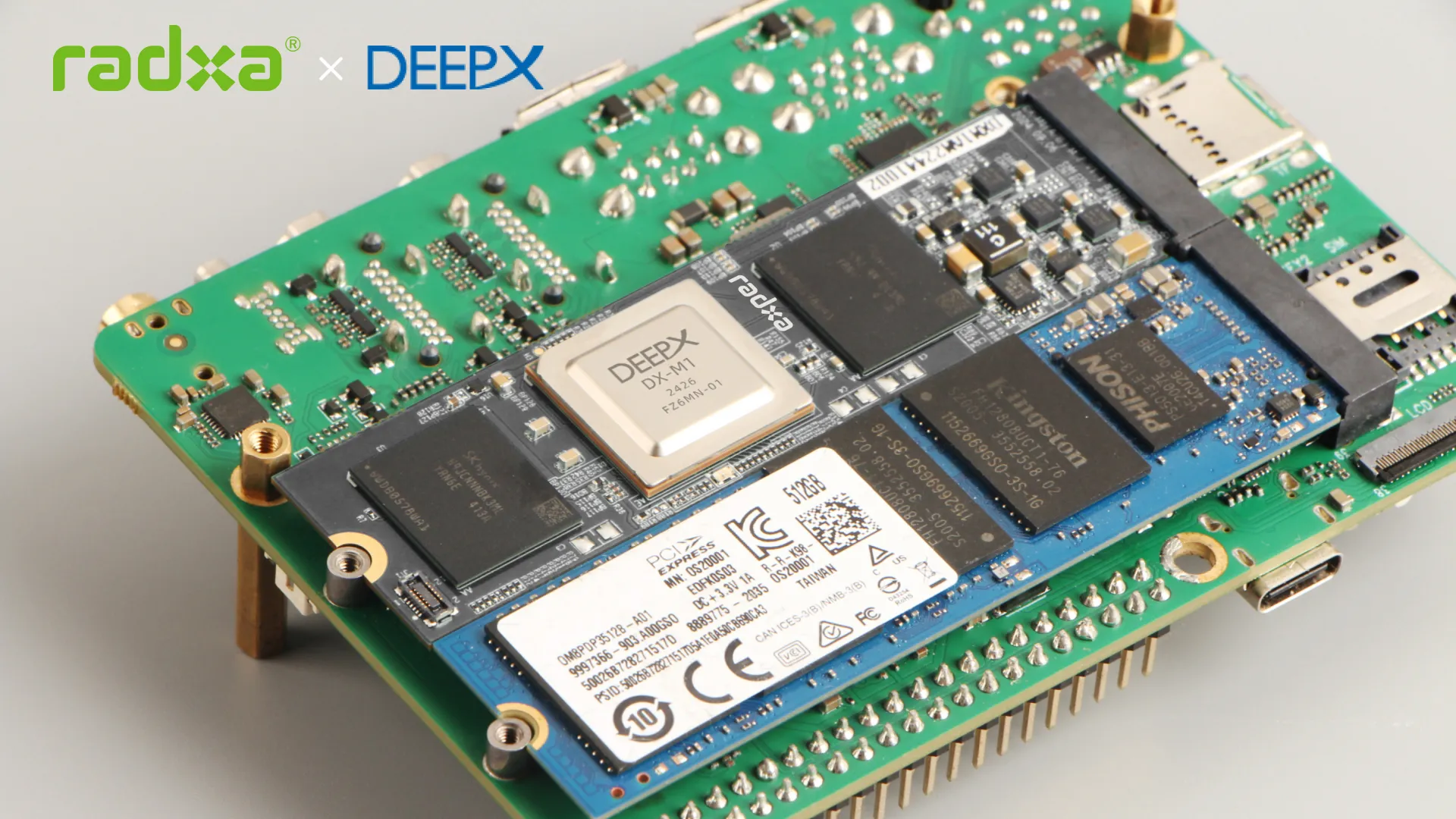

Insert the DX-M1 module into the M.2 slot of the ROCK 5B+ and power on. The ROCK 5B+ has two M.2 slots on the bottom, so even with the DX-M1 installed, another SSD can be installed if desired.

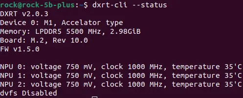

After installing the DX-NPU driver, the DX-M1 module should be correctly recognized on the ROCK 5B+.

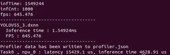

The DX-RT component facilitates inference for dxnn models. To evaluate YOLOv5s model performance on the DX-M1, we use the run_model benchmark tool.
Inference latency on ROCK 5B+ via the DX-M1 includes three stages: Latency = PCIe I/F (Write Time) + NPU (Inference Time) + PCIe I/F (Read Time).
deepx_5
Fig.6 DX-M1 Latency Analysis
# run benchmark
run_model -m YOLOV5S_3.dxnn -b -l 1000
deepx_6
Fig.7 YOLOv5s DXNN Benchmark Results
The average inference time is 4628.91 μs, i.e., 216 FPS, after 1000 inductions on the single-core NPU of the DX-M1. With three NPU cores, the theoretical maximum speed of the DX-M1 is 648 FPS, which is very close to the benchmark result of 645.476 FPS.

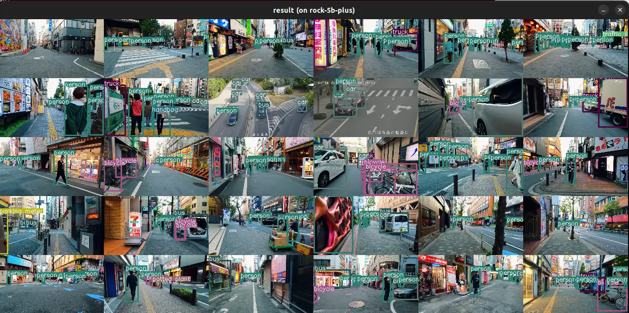

The DX-APP software package includes several computer vision demos that can be quickly deployed on the DX-M1 for tasks such as object detection and segmentation. In this example, Radxa performs object detection on 30 video streams simultaneously using the ROCK 5B+ and the DX-M1. The ROCK 5B+ decodes multiple video streams, sends the data to the DX-M1 for inference, and finally processes the output. It is worth to note that DX-APP recommends to use opencv 4.5.5, but since the FFmpeg version of the ROCK5B+ system is not compatible with Opencv 4.5.5, we compile the newest 4.10.0 version here.
# run multi-stream object detection
./bin/run_detector -c example/yolov5s3_example.json
Single-core NPU 30-channel video inference FPS: 240 FPS.
deepx_7
Fig.8 ROCK 5B+ Single-Core NPU 30-Channel Detection Output
