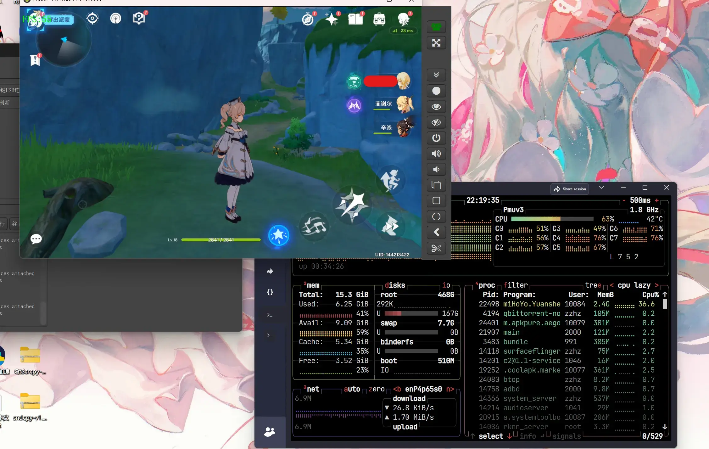

result
Here the QtScrcpy connection is used. result_play_yuanshen
